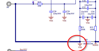

    The device senses charging or discharging current using the sense resistor connected to the SRN and SRP pins of the device. So, most likely the noises on the sense resistor path will cause this behavior.

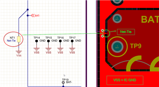

    Looking at the schematic, I see they have VSS (IC ground) connected to BAT-. We always recommend to separate the high-current path (BAT-) from the low-current path (IC ground). Often this is done by separating the GNDs with either Net-Tie or a 0-Ω resistor. A reference of this can be found in the BQ76952EVM User's Guide
    Please see our schematic below.

  • Hi Jose,
    Thank you so much for the tips.
    But we tried it and no result.

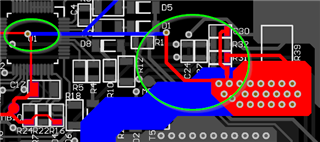

    The ground connection is only in the circuit, but there is a separate line on the PCB:
    We also connected the TS2 pin to the ground, but no change.
    The BQ IC still "sees" a current peak, even though the actual current is zero. Any idea why?

  • Hello Josel,
    Looking at the layout, the IC (U1) ground is being fed from the sense resistor. We recommend to not use vias and completely separate the Ground connections from the sense resistor. Please see below our EVM layout.
    EVM layout for sense resistor path

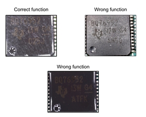

  • Hi Jose,
    Thanks for the good ideas. These are good tips for PCB design. But we tested it and no change. We connect the VSS pin directly through the wire to battery pack GND and the peaks on the current are the same.
    The procedure on connect cells to BMS is: First is to connect battery GND, then the connector, and last connect battery plus.
    Not all electronics have this bad feature. I send photos of fitted ICs. Couldn't they be fake?
    Please advise
    Josel
  • Hello Josel,
    It is hard to tell which IC is fake. Where were the ICs obtained from?
    They can order a few samples from ti.com and see if the behavior persists.
