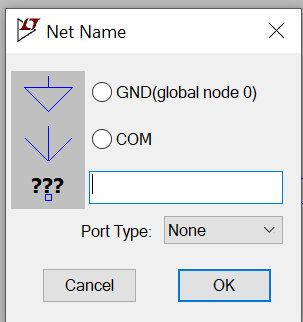

    While using this model I found that PSpice did not like having a "floating" COM node at all (I would have to ground the COM node to be able to run a simulation successfully). Whereas in LTSpice, there is a built-in support for a separate ground node (pictured below).
    Nancy

    The lack of a COM node is likely why the 5350 model works with more ease.
    I was able to run some tests with the 21750 model in pspice if i connected the COM node to the GND node.
    As far as I know, all of the UCC217xx models have this issue with the COM node unfortunately.
