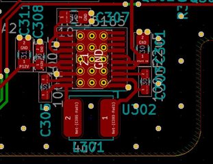

    I have screen shots of the relevant parts of the schematic and layout but I'm uncertain how to include them here.  The schematic matches the results of WEBENCH with Vin 9 to 12V6, Vout 12V, 0.25A
  • The layout.  Pin 1 lower right.  top and bottom ground planes stitched together

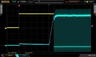

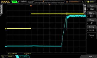

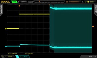

  • Some of the requested waveforms.  It is noted that the input voltage is 12.2V and DC output is 9.9V.  Earlier measurements were taken with Vin about 10.6V and Vout  just under 9V.
    Waveform is consistent with simulation except that the output does not reach 12V. Yellow trace is Vin. Blue trace is Vout
    waveform at L2, pin 20, at startup
    waveform at L1, pin 2, at startup
    All measurements taken with no load
  • Hi Jan,
    Could you check the chip that you are using is TPS55165-Q1, not TPS55160 or TPS55162? The three parts Vout configuration is different.
    I could see there is no big problem with the schematic.

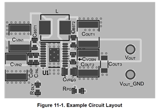

    But the layout has big difference with TI recommendation. For DC/DC converter, we saw more than 50% of issue is related to the layout. For example, the power trace (PCB trace between Cin, Cout, inductor to IC power pins) should be wide enough.

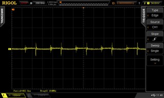

    AC coupled, spikes at switching less than 100mV peak to peak.
    If this is a layout problem what changes do you suggest? The caps on Vin and Vout are about as close to the IC as I can get and tie to a ground plane.

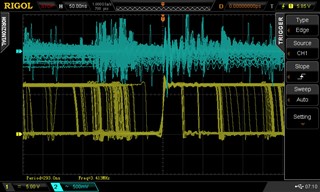

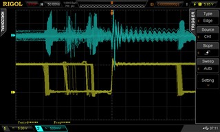

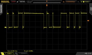

  • Here are the waveforms taken.  Vout is blue trace, AC coupled.  L1/L2 is yellow trace, DC coupled.  Sweep speed 50nS/div. Ch1(yellow) 5v/div. Ch2 (blue) 500mV/div
    L1, Vout
    Typical L1, Vout single shot
    L2, Vout
    L2, Vout single shot

  • Here's L1 at 500nS per division
    and both L2 (yellow trace) and L1(blue).  Same sweep speed
  • Hi Jan,
    It looks like the device operation is unstable.

    I don't see any copper planes on the layout, does it have polygon planes actually?
    Bryce
  • Hi Bryce,
    It already has an extra 22uF on the output piggybacked on the first one.  In fact, there are copper ground planes on both layers and it's pretty continuous on the bottom (green) layer.  The only layout related issue that may exist is that the ground side of both input and output caps are not as close to pin 1 as they could be.  I have made a change to reorient them and expect to have the bare boards next week to test it out.

    You can follow the TI recommended layout and share your file so we can review it for you.
  • The pad didn't get damaged.  In fact, the TPS55165 moved a bit when the solder was melted to rotate the inductor.  I consider this totally the fault of the technician (me).
    I have followed the example circuit layout and explanation to the best of my ability.  If anything the input and output capacitors are located closer than the recommended layout with the IC ground pad pin 1, and the capacitor ground sides all tied to a ground plane with no intervening traces.

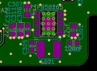

  • Here is the current layout
    red traces top side. Copper pours shown in outline form. Top and bottom copper pours connected to ground.
    Here's the bottom side filled, top side hidden

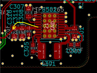

  • Thank you for your message Kahn.  I've been using KiCad for more than 10 years now both professionally and personally.  I've done the layout according to the principles set forth by TI as well as what I've learned over the years.  Minimize the loop area of the switching paths.  Keep the ground connections as close as you can and don't cut into them, for example.  I'm more than willing to revise the layout IF there is something specific identified.
  • Jan,
    Now that I think about the problem and look at your layout design in detail I have had exactly the same problem in my buck converter design. You see the VOUT_SENSE pin connection in your layout, it is not supposed to be connected directly to the VOUT pin it has to be connected after all the output capacitors. Like I showed in the picture below. I know it is the same node and normally it shouldn't matter where you connect a trace on that node but in this case, VOUT_SENSE is working as feedback to control the output voltage so it has to come from the capacitor. Try this and I bet it will work 100%.
    If you want to try it before you change the layout and order PCBs which is a hassle and could potentially take another week or more. Lift pin 16 up until it disconnects from the footprint then solder a jumper wire from the pin to the last output capacitor C316. It will take a bit of soldering gymnastics but it will be fun. Follow this tutorial if you need to, https://www.sparkfun.com/tutorials/99, they explained it quite well.

  • Hello Khan,
    I was able to cut the connection between pins 16 and 17 without breaking the pin 17 to output. And I added a wire  from pin 16 to the output cap at C316. This is a board that powered up with an output of 10.3V.  After the modification, it powers up to 12.03V.  Right on the mark. I think your suggestion has solved the issue.  I'll make the mod to a second board to confirm and then make a minimal change to the layout to match the kludge.
    Thank you.
  • Second board modified.  Second board is working as it is supposed to.  Problem solved.  Layout has been changed.
