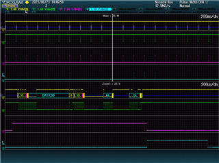

  • Hi Wyatt-san,
    After GE=H, there is a timing where INITCOMP goes high 1.2s later, followed by INITCOMP going low 1s later. The reproduction rate is low, but it is occurring at arbitrary times.
    Is there any possible cause for this?
    Kagawa
  • Hello Kagawa,
    What is the occurrence rate for this behavior? The only time the bit should be reset is during some type of reset event. What exactly is happening in the system (commands too) when the bit is cleared?
    Sincerely,
    Wyatt Keller

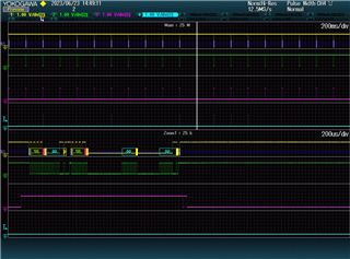

  • Hello Wyatt-san,
    The waveforms were measured by creating a program to check that INITCOMP=H at 100ms intervals during the first 10s after startup.
    The success waveform (Figure 1) takes slightly longer to return an ACK, while the failure waveform (Figure 2) is shorter, with a response value of 00.
    1. What is the estimatied cause of the following phenomena?
    Figure 1 Successful waveform (INITCOM = H)
    Figure 2 Failure Waveform (INITCOMP = L)
    2. Answer to your question
    The incidence at room temperature is roughly 1%, which is very low. The waveform at startup recognizes that no reset has occurred. The command is shown above.
    Kagawa
  • Hello Kagawa-san,
    It may be best to reset the gauge when this occurs so it re-initializes. It seems something during the initialization process fails, or possibly the gauge has some type of momentary brownout which would cause the gauge to re-initialize.
    Sincerely,
    Wyatt Keller

  • Hello Kagawa-san,
    I reviewed the firmware, the only way for this bit to set to 0 is if there is some type of brownout condition where the gauge loses power. At power up it is default 0, but after the first AD process it is set to 1 and no other points is it set to 0.
    The only other possibility is some type of data corruption if the brownout/reset is not occurring.
    Sincerely,
    Wyatt Keller
  • Hello Wyatt-san,
    Customer said:
    I have rewritten the FW multiple times and checked it again, but the result is the same as the last time and has not changed.
    Should the customer request an IC analysis?
    Kagawa
  • Hello Kagawa-san,
    I think it is very unlikely that anything would be found from IC analysis at TI, the code shows the exact behavior of this bit. It seems there may be some poor timing of events that is causing some type of reset to occur. This can be from brownout, I2C communication too quick causing a WDT reset, etc. This is happening to 1% of the gauges and is reproducible only with the 1% that have failed before.
    Sincerely,
    Wyatt Keller
