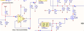

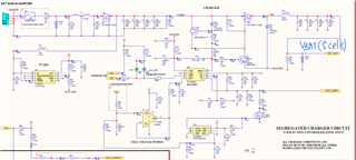

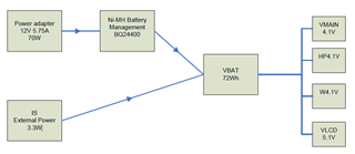

The attached is our schematic diagram and power distribution diagram. Problems encountered: The adapter is plugged into the instrument, and after the instrument is fully charged, it is discharged until the instrument automatically shuts down, and the automatic shutdown voltage of the instrument is set to 5.1V.
The instrument is used outdoors for a long time. The battery is 5 NiMH batteries connected in series.
I want to know:
1, Adapter was always pluged, why can't the instrument be charged again? What is the main reason for this?
2, Adapter was always pluged, if we want the instrument to automatically charge, can you give a few solutions? (Don't revise the PCB layout).

    The pin4 is the voltage form battery voltage(180kΩ+66.5kΩ), the pin5 is connected NTC to GND, 1.9V normally.

    I need to know the voltages at the IC pins 4 and 5.  You have additional circuitry that I do not understand (as shown below) connected to those pins.  I suspect one of those is not working correctly and causing the charger not to recharge.

    The voltage for Pin4 is more than 1V at the condition of Vbat=5.1V, that can be calculated by =VBAT*(180K+66.5K)/(1M+180K+66.5K). and the voltage for Pin5 is about 1.9V that tested by multimeter.

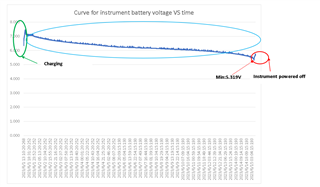

    I rembered that I have the picture about curve of voltage that collected by Data Acquistion(Brand:Agilent) every 3minutes, the minmum of voltage is 5.319V. From the curve, we can get that charge full battery fistly, and than discharge. During discharge process, the BQ24400 can't start charging. Hope that can help you to analyse.

    It does not automatically recharge when the battery voltage droops like our newer chargers.  You may need to add a comparator and a latch that detects when charge is complete and then indicates when recharge needs to occur. Then you could send a pulse to turn off Q2, which would make the charger think power has been removed.
