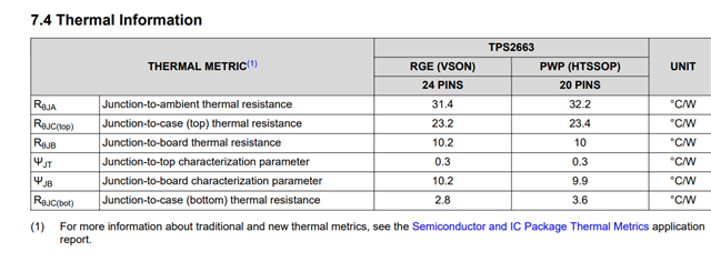

Hi team,
I have a customer design in TPS26630RGER_VQFN24 and they are doing thermal test.
They want to know how much Ta and Tc and is there any information about that?
