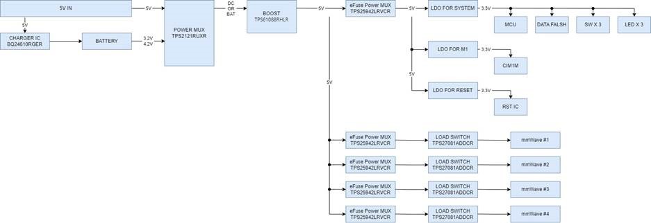

Hi, TI expert.
The customer is designing H/W that can operate mmWave 4ch.
The mmWave products under review are the IWR6843ISK and IWR6843AOP.
IWR6843ISKIWR6843ISK Evaluation board | TI.com
IWR6843AOPIWR6843AOP data sheet, product information and support | TI.com
The customer wants to test this product by configuring 4ch.
The configuration of the input power stage is as follows.
1st : 5VDC phase power
2nd : Battery
3rd: PoE
For switching of the above three power sources, we want to use Power MUX.
The figure above is the power stage to be designed.
We want to add PoE to the picture above.
The customer requested a suitable device recommendation to apply PoE (Power over Ethernet) to H/W.
Can you recommend a suitable PoE IC?
Please check. Thank you.
