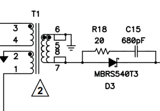

  • That you so much. I will look at it in more detail next week. One more question, it looks like the transformer may not be available anymore, if true what would be its replacement? I don't even see the winding info either? how does POE13P-24L winding compare to this one?
  • Hi Rob,
    Thanks for your follow-up.
    POE13P-24L looks good for 24-V ~500 mA application. The windings is
    If you have a TPS23753AEVM-001, it looks easier to do some jump wires to only configure the secondary side.
    If you have a TPS23753AEVM-004, it may need more jumpers.
    Diang

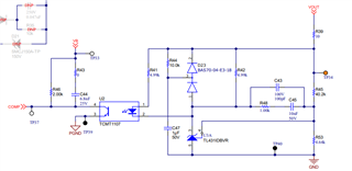

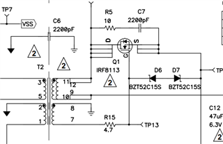

    I have converted the -004 to -005 (12V 1A) and  it works fine at the voltage level. I have ordered the transformer to get it to 24V @ 500ma. If you Please confirm  the following:
    I don't need the sync feedback, remove Q1 and D6 and D7 jumping across Q1
    Replace R19 (10K) and R24 (1.15K) for U3 ref voltage
    Replace R8 (LED) 6K
    I don't think I need to adjust Bias Feedback area - right?

    "I don't need the sync feedback, remove Q1 and D6 and D7 jumping across Q1": you may need to put a (>= 80V, >= 2 A) Schottky diode to replace Q1 to complete the flyback converter.

  • yes, the caps that I change out per the 12V BOM may have to change to 30V. in the 12V BOM R22 goes to 2.49K and R21 moves to 15K. I'll cal the current but they may have to change too. I guess just jumper Q1 out of the equation is not enough? When I review the norm circuitry there is no drive secondary to deal with, or am I missing something?.
    Last question does the R19 and R24 make sense to you and U1 side of the feedback can be left allow - right?

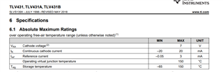

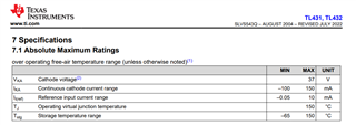

  • Hi Rob,
    Just found the cathode voltage of  TLV431 is only 7 V.
    TL431 with 37-V cathode volatge may be suitable for 24-V operation.
    TL431 has ~2.5V reference. You may use the following parameters for compensation.
    Diang
  • Hi! looks good and yes the tlv431 must move to tl431, which I have done when I move to 12Vdc.. Last question: what schem (where TL431 is at) did you pull the schem from, can I get the whole schem?
