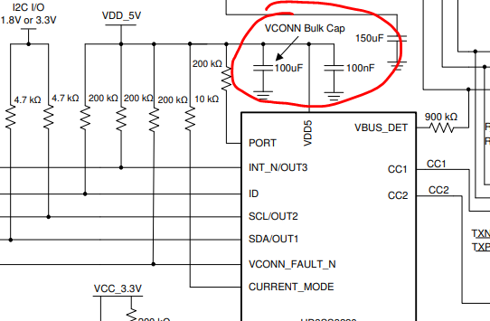

1. customer want to know would the VDD5 consumption current increase after a device plugged into DFP port ?
2.why we need extra 100uF at VDD5 pin at DFP case?

1: if a device plugged into DFP port, 3220 in active mode , current should be increae.
2: 100uf cap is for Vconn which supports active cable.
Best
Brian
Hi Brain,
1. you mean increase to 0.7mA ?
was this 0.7mA measured under active cable plugged or not?
2. why does Vconn needs that large capacitor for active cable?
1: when mux is on, current is increased to 0.7ma.
2: active cable has IC inside , it may draw large current.

0.7ma is not directly from active cable, it's from Mux inside .

Hi Brian,
I mean this 0.7mA doesn't include active cable loss , right?
the pull down Ra loss. can you confirm this?
Hi Brian,
so our datasheet current consumption doesn't cover active cable loss scenario inside at all?
you may right, but 5v/200k=0.025ma, not too much compare to 0.7ma.

hi Brian,
I’m confused what you meant,
Ra is 1kohm, 5V/1k=5mA.
so clearly it doesn’t cover active cable since the current now is only 0.7mA<5mA.
am I right?
if we can internal limited 200K , then why do we still have to worry about large current sink from active cable?
Hi Brian
i’m confused I didn’t see any external 200W ohm at VDD5?
why you keep saying there’s 200kohm?
I think you mistaken for the Vconn_fault pin which is not a supply pin…..
sorry, I'm confused with Vconn supply and Vconn_fault which has 200k external pullup. let me check with system.
brian
Afterr confirmed with our system , the current 0.7ma did not include Vconn, it will be higher as you mentioned.

1. so do we really need that as large as 100uF?
2. should we place it as close as possible to the mux or close to 5V DC/DC is fine as well?
1: we do need 100 uf for Vconn since you need to plug cable to avoid vcc don't drop too much.
2: it's better close to mux.
