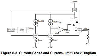

Figure 8-3 of this devices datasheet shows a current source if IOUT / KILIM being sourced out of the ILIM pin.
Can someone confirm that KILIM = KCL? KILIM doesn't seem to appear anywhere else in the datasheet.
Thanks!

Hi Andy,
This is a typo. K_CL and K_ILIM are the same,
Shreyas
