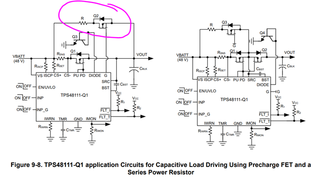

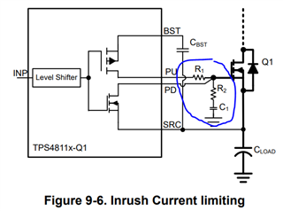

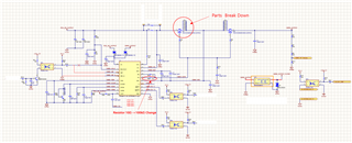

TPS4811-Q1: MOSFET Broken out during test with load supplied by loader
Part Number: TPS4811-Q1
The problem that the MOSFET does not turn on was solved by changing the PU resistance 0Ω -> 100kΩ
However, if the operation signal is input with a load of 8A or more supplied to the load, the MOSFET is burned out.
※ Short circuit remains when measuring MOSFET gate-source
- Anomalies
   When supplying 8A load, there is a sound of something hitting.
   What should I do to prevent the MOSFET from burning out?
