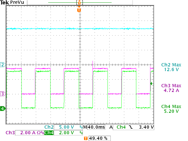

We set up the test environment for TPS563207. Initially, the output current was set to 3.5A, which is higher than the datasheet's maximum value of 3A,but the current limit is 4A. However, it immediately triggered  and hiccup ,.I would like to know the behaiver of OTP.
(CH2: Vin/CH3: Iout/CH4: Vout)
To confirm the behavior of OTP causing Hiccup,I also do some tests as below.
1.Heating by Hot air gun.
The frequency of V-out rising and falling is faster, approximately 40ms voltage drop compared to the original 448ms, which is 10 times shorter. The retry time has also increased from 22ms to 40ms. Why isn't V-out pulled directly low after OTP? Shouldn't the voltage be dangerous even with OTP?
2.Cooling by FAN.
Why does the retry time still remain at 22ms? The fan helps in faster cooling, so shouldn't it be shortened?
If 22ms is an internal natural cooling mechanism of the IC, is it possible for the temperature inside the IC package to decrease by 37℃ from 172℃ within such a short time?

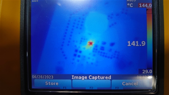

     Continuously draw a current of 3.5A using an electronic load machine.
    After approximately 6 minutes, I observed a Tc temperature of 141.9℃ on the oscilloscope's Hiccup waveform using an infrared thermometer.
     the internal temperature of the IC at this moment using the formula.
    PD=3.5*5/0.8198-3.5*5=3.84℃/W
    Tsen=3.84*0.9+141.9= 145.356℃  < 172℃ (thermal shutdown limit of datasheet)

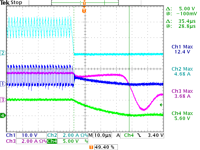

    The waveform behavior as follows.
    (CH1:SW/CH2:IL/CH3:Iout/CH4:Vout)
    CH2:Inductor Valley current=1.92A < 3.3A(min)
    CH4:Output voltage threshold >65%
    None of the above conditions have reached the OCP criteria, so the observed behavior of Hiccup at this time is unlikely caused by OCP. Additionally, the temperature has not reached the OTP thermal shutdown threshold of 172℃.
    So we would like to discuss: Is this Hiccup behavior triggered by OTP or OCP ?
