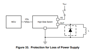

2) As per slvaes9a the loss of ground  or loss of battery we need following approach on the picture
In case we have a blocking diode on Vs (methode1)  do we still need the Gnd network and series resistor if we want protect against loss of gnd and loss of battery?

    2) For loss of battery protection, there is the alternative of adding a flyback diode in parallel with the load (shown in the picture below). This would still require the series resistors, but not the ground network. As for the protection against ground loss, the solution shown in the figure you referenced (1.6) is only necessary if there is a loss of module ground and a low-impedance path exists between the input supply line and the module ground of the HSS. If these conditions are not a concern in your application, the solution can be skipped.

  • Hi Gabriel,
    the picture that you posted is not showing for me, pleas can you repost?
    Br,
    d.
  • Hi d,
    Here it is:
    If you still can't see it, it is Figure 33 on the datasheet (section 8.3.7.3).
    Gabriel
