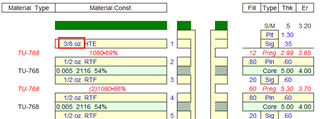

Q3) Looking at the Layerout structure and EVM Data, the PCB space seems to be insufficient. Currently, the top pad thickness of the PCB to which the chip below is to be applied is 3/8 oz. Are there any problems that may occur due to the small contact area of the In/out Pin?

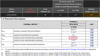

      They couldn't find information about the power dissipation value below among thermal related materials. please tell us this value

    4. Power dissipation you have to calculate. It is I*I*RDSON. Tj=TA+ (RQJA*PD)

    Q3 ) The top pad thickness of the PCB they apply the device to is 3/8oz. When proceeding according to the routing guide below, please give your opinion on whether there may be damage to the PCB pad where the chip is attached.
    There is no reference data because interlayer PCB thickness information could not be found in the EVM Board design data.
    Q4 ) Please tell us what is the power dissipation [W] Pd value of the device. They plan to calculate the Tj value to see if there is a thermal problem.
                Tj=Tcase+ (ThetaJC*PD)

    2. PD= I*I*RDSON
