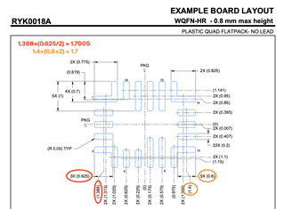

There seems to be a mistake in the example board layout in the datasheet for the BQ25622
The pads are not centered, the entire footprint is offset in the X axis by 0.0005mm

Hello Nicholas,
Thank you for the suggestion we are looking into it further.
