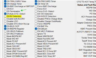

Hi ti Team,
My application needs to remove the battery frequently. Does bq24179 support battery in-place detection?
When the test Bq24179 has no battery, the voltage at the Vbat end will jump from 0V to 8.4V. Is this normal? Is there any way to make the Vbat voltage close to Vsysy without a battery?
