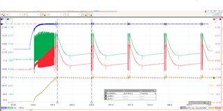

  • below is the input (blue) / output (Red) waveform. After 1st start LM5176 ICs got damage (mean No output signal and output +ve to output gnd showing low resistance (~100 ohm)).

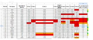

  • We have done some exercise, we had measured all damaged ICs ohm, mean measured resistance between each ICs pin (from 1 to 28) wrt AGND pin for all damaged ICs. Surprisingly it is observed that every time same pins getting damaged as shown in below sheet.
    No color value are in Mega ohms
    Red color value are in ohms (R)
    Other color value are in K ohms

  • Hi Shankar,
    Thanks for reaching out. You can try to increase the input capacity and increase the SS capacitor in order to stabilize the input voltage while ramping up.
    Moritz

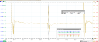

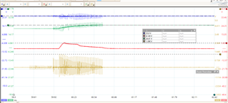

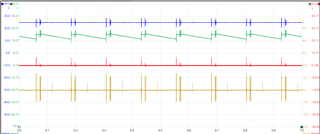

  • Hi Brigitte.
    Below is the boost node waveforms.
    Blue => input voltage (25V)
    Green => SW1 node waveform
    Red => SW2 node waveform
    Yellow => Output waveform
    Seems system getting restart after every 115mSec.
  • Hello Shankar,
    This looks like hiccup mode. This happens if the device is getting into current limit. Please check if your peak current supports the boost mode. In boost mode the peak current in the inductor is bigger than the output current.
    Brigitte

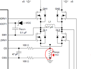

  • Hello Kanki,
    Just to understand your circuit, I reviewed again the measurements you sent and I can not see in any of the measurements the set 30V. So something is not working as expected, as I expect the output to reach the set voltage during normal operation, especially when you mention that there is no load.
    Please check the voltage from CS to CSG while you are operating the device in boost mode only.
    MODE pin does not influence the hiccup timing or current threshold. It just defines if the device is operating in hiccup or not. The device goes in hiccup mode if it operates in overcurrent for several consecutive cycles. In normal operation the device should not go into hiccup at all.
    Brigitte

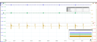

  • Hello Brigitte,
    Yes, we also curious to know from you, why it is not working even for no load.
    Below is the CS to CSG waveform.
    Blue => input 25V
    Red => Input current
    Green =>Output voltage (only 24.41V not getting 30V)
    Yellow => CS wrt CSG waveform
    Zoomed waveform:
    Full waveform:
    Please suggest further action on the same.

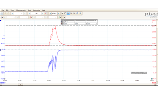

  • Further update.
    Now we have disabled Hiccup mode (mean, 200K ohm connected between MODE pin and GND).
    Still there is no expected output (30V) and it is showing same as input voltage.
    Below is the waveform
    Blue => Input voltage (20v)
    Green => Output voltage (20V, expected is 30V)
    Yellow => CS & CSG waveform
    Awaiting for your suggestion
    Thank you!

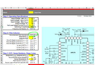

    BTW, As we are rechecking "quick start tool" excel sheet which was shared by TI team. We have one query
    Our system max load is 60A and based on this we are getting inductance value as ~1uH.
    But as you know we are doing testing our system with No load Or min 1A load.
    considering this load the calculated inductance value (from Quick start sheet) it is showing higher value (53.5uH)
    So for our system
    Vin min 27
    Vin Max 33
    Iout :0 to 60A Max
    Note: Could you please guild us which inductor value should we use for our system (1uH or higher)?
    Awaiting for your valuable quick response.
    Thank you!
  • Hi Shankar,
    You should use 1uH inductor for your application.
    But I think it is really challenging for you design now:
    You used TO220 MOSFET which has a high parasitic inductance, please check SW1 and SW2 stress (positive and negative spike); I believe you cannot meet the Absolute Maximum Ratings below.
    Please check if adaptive dead time function properly.
    Also the conduction loss is very high at 60A.
    Feng Ji
