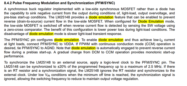

Hi Team,
My customer is planning to implement LM25148 into their modular IO project. Some questions to ask regarding the diode emulation feature.

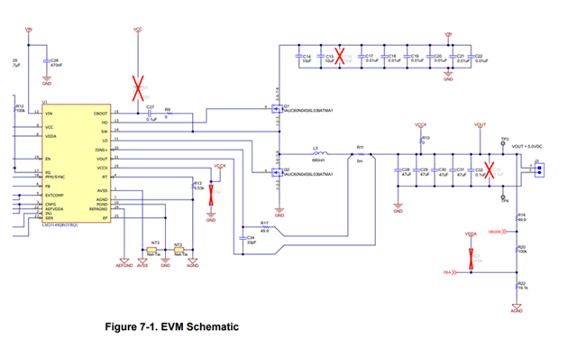

If I want to enable diode emulation mode, any additional diodes needed to be added inside the circuit? As I can't see any diodes inside the block diagram around the LO pin, or from the EVM schematic.
