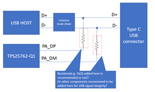

Could you kindly advise:
1) What's the behavior of TPS25762-Q1's PA_DP/PA_DM PIN after BC1.2 negotiation is done? Will these 2ports turn to Hi-Z internal?
2) Customer would like to connect PA_DP/PA_DM to USB port D+/D- for BC1.2. HOST IC also need to connect with USB connector D+/D- for USB2.0 normal communication. Do you have any recommendation for the D+/D- connection for USB signal integrity? See below simple block diagram.
Many thanks!
Terry
  • Hi Terry,
    Suggested not both connecting to 762 and host IC.
    One BC1.2 controller should be added, such as TPS254900A-Q1.
    So USB-C connector connects to TPS254900A-Q1 then to Host IC.
    If host IC is integrated with BC1.2 controller, TPS254900A-Q1 can be saved.
