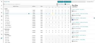

  • Hello Albin,
    Yes, if you successfully WAKEUP the 79600, the light should turn green.
    Are you able to use a LOGIC analyzer to see if the data is being transmitted correctly?
    Below I am using the BQAutoEval GUI from the BQ79600 Page to look at all the registers for the BQ79600.
    The wake up is located in the control1 register which has an address of 0x309 and you'd need to send a command of 0x20 to use the SEND_WAKE command which is on the 5th bit. I would suggest downloading this GUI to give you a more intuitive sense of the register map and see if you are getting data on the TX line.
    I hope this helps give you some guidance. Let me know if you have more questions or if this resolves your issue.
