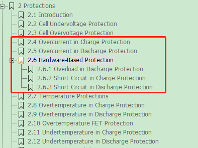

【 Hardware-based protection】In sections 2.4, 2.5, and 2.6 of the TRM document for bq4050:
1. Customer wants to know what is the difference between short-circuit protection for charging/discharging and overcurrent protection? Is the speed of short-circuit protection faster?
2. 【 Hardware-based protection】Is the unit of delay time for short-circuit protection here seconds, ms, or something else?
Annie
  • Hey Annie,
    1. Overcurrent protection is a firmware based protection while the short circuit protection is hardware based. Hardware protections are generally faster.
    2. For short-circuit protection, it is in terms of microseconds. Delay time for hardware protections are outlined in the datasheet.

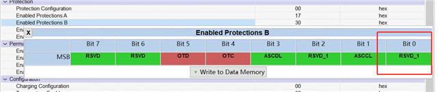

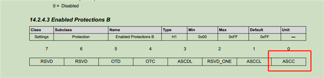

    In chapter 14.2.4.3 of the TRM document of bq4050, there are ASCC control bits. But in the bqStudio software, there is no such control bit. Is the ASCC function enabled by default?
    In addition, in chapter 14.2.4 protection, there is no [ASCD] setting bit, only [ASCDL] setting bit. Is the ASCD setting bit also enabled by default?
    Annie

  • Hello Annie,
    The bit should be reserved and not changed from default. Hardware protections are always enabled so you cannot disable them. If you toggle the bit from default the protection will still turn off the FETs but the register page will not show the ASCC failure, which can be confusing if trying to debug.

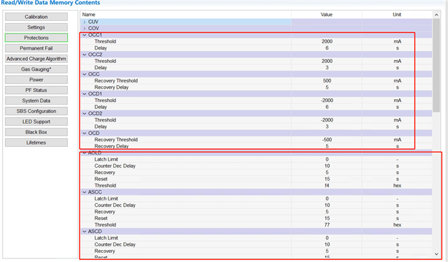

    The customer has made the ascd (discharge short circuit protection) function. The parameters set are ASCD->Threshold1 = 73, ASCD->Threshold2 = e3. The following two experiments were done:
    1. Enable ASCDL function (ASCDL bit of protections B = 1)
     Latch Limit = 0, Counter Dec Delay = 10S, Recovery = 5 S,Reset = 15S
    2. Disable ASCDL function (ASCDL bit of protections B = 0)
    In the above two experiments, no short-circuit protection was seen, and the ASCD bit of the safety status was 0 (green).
    May I ask why there is no discharge short circuit protection?
    Annie

  • Hey Annie,
    I looked over the log file and gg file and the gauge seems to be working as intended. The ASCD protection did not trip because the gauge did not measure the required current for this protection to go off. If the threshold is set at the lowest setting "0x00", then the gauge will need to measure at least 22.2 amps to trigger this protection. This is calculated by taking the threshold voltage (-22.2mV) and dividing that by the sense resistor value (since you are using the EVM, this is a 1 milliohm resistor). Thus -22.2mV/1mOhm = -22.2 amps. However, the OCD protection is working as intended since the Safety Alert bit was set during the discharge.
