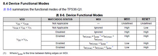

    Thank you for your reply. I'd like to confirm three points.
    watchdog is disabled
    For WDI, WDI is ignored as this table shows, right?

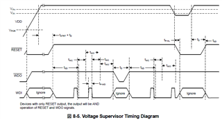

    As far as I saw this diagram, MR pin is behaves as if it was V_DD because t_WC starts after t_D and t_SD terminated, right?

    1) For WDI, WDI is ignored as this table shows, right?
    • When watchdog is disabled or not acceptable, WDI is ignored.
    2)  As far as I saw this diagram, MR pin is behaves as if it was V_DD because t_WC starts after t_D and t_SD terminated, right?
    • MR  (manual reset) is an  active low pin, which mean the circuit is reset when the this pin is driven low.
    • There are 2 condition can cause a reset. One is Vdd goes under the threshold or MR pin is asserted. After these conditions goes high again, as you said,  t_WC starts after t_D and t_SD terminated.

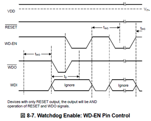

    3) The difference between WD_EN and MR is whether it contains t_SD, right?
    • If there is an WD_EN pin, the watchdog enable disable functionality is controlled by the logic state of WD-EN pin. Drive WD-EN = 1 to enable the watchdog operation or drive WD-EN = 0 to disable the watchdog operation. The WD-EN pin can be toggled any time during the device operation.
    • The moment it's enabled, the device immediately enters tWC frame and start watchdog monitoring operation.
