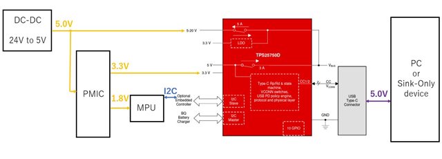

(a) There are three types of profile settings for TPS25750D: DRP (prefer power source/sink), sink only, and source only.
Is this correct? (There is no "do nothing" profile, right?)
(b) In the attached block diagram, we are considering setting the TPS25750D to DRP.
If the 5.0V on the same board as the TPS25750D is turned off and connected to an external USB device, the TPS25750D will be configured as a sink device.
After that, I believe that PD negotiation will not occur even if 5.0V on the same board as the TPS25750D is turned on.
(I understand that USB PD negotiation is only performed once when a USB device is connected.)
Is this perception correct?
(c) Please let me know if there is an event where PD negotiation is performed other than when the USB PD device is connected.
    Yes.  This is correct.
    If the 5V onboard is not available, then this would be the dead battery case.
    Do you want to initiate a role swap after the onboard 5V is connected?
    I will need to double confirm but the request for role swap would initiate PD negotiation.

    (b') "dead battery configuration" is what I understand to work when onboard 5V is not available and PD negotiation is not done.
    (That is, we don't refer to the "dead battery configuration" behavior in this case.)
    There are three different dead battery configurations.  For both the AlwaysEnableSink and SafeMode the USB PD is disabled.  For the NegotiateHighVoltage the PD controller will enter the APP mode and negotiate the highest contract available up to 20V.  https://www.ti.com/lit/ds/symlink/tps25750.pdf#page=45

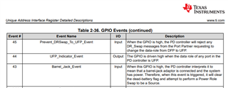

    (c') I would like to know if there is a way to do a power role swap after the onboard 5V is connected.
    Also, is it safe to assume that roles will not be swapped unless a role swap request is made?
    (We want to avoid unintended role swaps.)
    There are 4CC tasks.  https://www.ti.com/lit/ug/slvuc05a/slvuc05a.pdf#page=44
    You can also use a gpio event.
