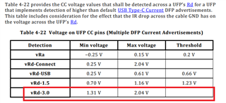

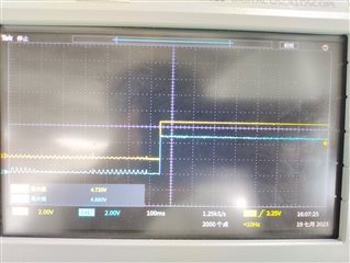

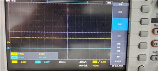

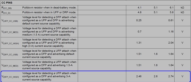

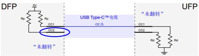

HI, my situation is that HD3SS3220 is DFP mode and CURRENT_MODE pin is set to H (ie. current advertisement is 3A). When the UFP is attached, i measure the voltage of CC1 or CC2 is about 1.6V, not 2.6V (according to the datasheet in Page 6 V(DFP_CC_HIGH) should be 2.6V). I am puzzled with it many days. Can you tell me how to resolve it?
Thank you!
