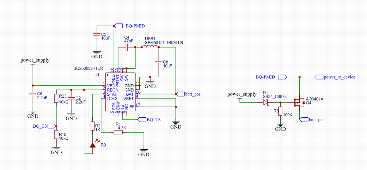

I have created a charging circuit using the BQ25303JRTER. The dataqsheet states the following at charge faults:

    Before debugging, could you please confirm your design follows Figure 10-1. Typical Application Diagram on the d/s?

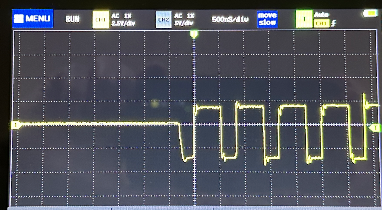

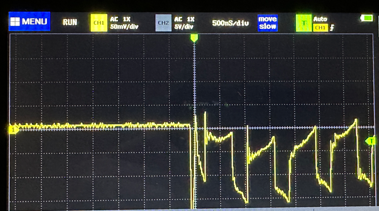

  • I have tried the system with a bigger powersupply but to no avail. The stat pin keeps blinking and the battery is not being charged. I borrowed a simple oscilloscope but I do not know how to interpret it. I have taken a measurement before and after the inductor. The power supply appears to give a pretty undisturbed 5V.
    Before the inductor:
    after the inductor:
    The 21700 battery connected to the system had a voltage of 3.5V.

  • I want a charge current of max ~2.8A, so I found a KICHG value of 39800 in Figure 8-5. Given that RICHG = KICHG/ICHG, I found I would need a resistor of 14.2k from the ICHG in to GND. Because 14.3k was the closest resistor available, that is the value I chose.
