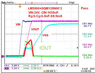

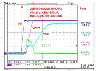

LM5060: the start-up waveform for Iout
Part Number: LM5060
hI
In LM5060 datasheet figure 34
the Iout wave   is dffrent from my design (green waveform Iout)
Figure 34 show, Iout is rising to peak after Vout  full on.
but my measure waveform is  Iout is rising to peak before Vout  full on.
can I  turning my design let Iout is rising to peak after Vout  full on. (red waveform)
it help me to get better SOA waveform .
