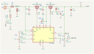

LM7480-Q1: Low V(DGATE)-V(A)
Part Number: LM7480-Q1
Other Parts Discussed in Thread: LM7480
I'm working through this design with the LM7480 but have found that the voltage between the DGATE and A pins is 3.05V rather than the expected >11V at a supply voltage of 16.8V. The HGATE appears to function as expected.
