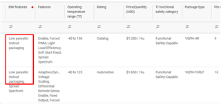

Some datasheet specify Hotrod trademark and some datasheet doesn't. What's the difference?
In case of filtering Hotrod feature, the package is VQFN-HR or VQFN-FCRLF or WQFN.
But VQFN-HR package is not Hotrod always.
    You are filtering on an EM feature for a Low Inductance Hot-Rod Package.  While all of the Hot-Rod Packages are Low Inductance, not all of them are specifically designed to help reduce EMI, so not all Hot-Rod packaged devices are tagged with the "Low Inductance Hot-Rod Package" EMI feature, so they are not all coming up when that filter argument is selected. The lack of the tag may be an oversight, or may be that the device or package was not specifically targeting reduced EMI.  Those with the Low EMI feature will have the best EMI performance.  Other Hot-Rod packaged devices will generally also have improved EMI performance over other packages, but not necessarily as good as those with the Low EMI feature.

    Probably, Low EMI feature means, measuring emission by near-magnetic-field probe and the emission amplitude is low enough.
    It's not very important for me. My concern is spike noise amplitude on VIN and VOUT conductor line, then a little different.
    Anyway, I understood
      -VQFN-HR package is necessary condition
      -low parasitic package and small value capacitor just next to IC
      -exact value will be decided by testing on parts mounted board
