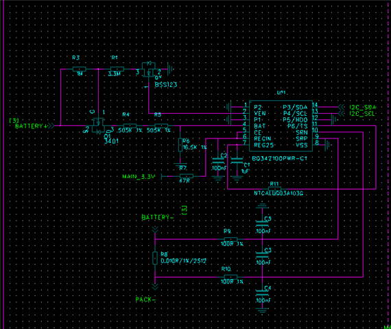

Design with following questions:
1) The chip captures batteries up to 48V, and the official reference board is designed with a number of chips. Is it possible to simply design with the BQ34Z100-G1?
2) The BQ34Z100-G1 design is shown in the following figure:
3) One battery is B+ B-, where is Pack- connected?
4) 11 pin of the chip recommended NTC-10K, is it for temperature detection? If not being used, can the pin be left floating?
5) BQ34Z100-G1 and GD Single Chip go I2C Communication, is it required additional pins?
6) 1 3 is actually an LED output pin, what do these LEDs mean? It doesn't have to be grounded right?
Could you help check this case? Thanks.
Cherry
  • Hello Cherry,
    1. bq34z100-G1 can be used as top of stack gauge. If cell balancing is not required, then this gauge is well suited
    2. Not a question
    3. Pack- is connected to load/charger negative terminal
    4. Temperature sensor is required for accurate readings. It should not be left floating
    5. I did not understand this question. I2C pins are brought out from the bq34z100-G1
    6. TRM section 3.9 LED Display described use of LEDs
