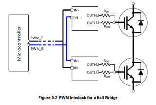

Dear Specialists,
My customer is considering UCC21750 and has a question.
I would be grateful if you could advise.
When using both IN+(10PIN) and IN-(11PIN),
We are thinking of using single-ended output from the control board (microcomputer) side, converting it to differential with a differential driver, and supplying it to IN+ and IN-.
If possible, could you please let us know the recommended single end to differential device.
I appreciate your great help in advance.

  • Hi Shinichi,
    IN+ and IN- inputs are not differential inputs, they are single ended wrt to GND. Please check device function mode table (section 8.4 of the datasheet) on how INP, INN along with other conditions on the OUTH/L status.
  • Hi Shinichi San,
    We would recommend just tying the IN- to GND as the method you're suggestion would just add cost to the system and is not necessary. Please refer to section 9.2.2.2 (page 33) of the datasheet which says, " When only IN+ is used, IN- can be tied to GND"
    Please let me know if you have further questions.
    Hope this helps!
    Pratik
  • Hi Sasikala and Pretik,
    Thank you for your reply.
    I understand.
    IN+ and IN- inputs are not differential inputs, 2 single end signals.
    The customer is also thinking PWM signal to IN-.
    Could you please advise.
    My understanding, when using only IN-
    IN+: Direct 3.3V or 5V
    IN-: Input a signal that reverses PWM to the control board (microcomputer) side
    In this case, is it possible to pull-up IN- for a noise countermeasure.
    I appreciate your great help and cooperation.
    Shinichi
  • Hi Shinichi San,
    Adding low-pass filters to IN+, IN– pins can effectively increase the noise immunity and increase the signal integrity.
    Yes, separate single ended inputs can be used as mentioned in table 8-1 of datasheet.
    Yes, only using IN- works and tying IN+ to VCC works too. The problem is that it makes the driver default ON instead of default OFF. This can be solved with a pullup on IN- because this makes it so that if the MCU/controller is not actively driving the IN- pin, the IN- pin will pull high, turning the output off.
    Pratik
