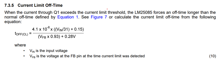

    1. Why even though the inductor current has been reduced to 0, LM25085 still does not return to the switching state, and restarts after about 100-200us. (Which should be restarted immediately).
    According to the datasheet, the current limit off-time should be calculated as the following equation:
    And based on the circuit of my customer, the off-time should be 4.5us, instead of the actual 100-200us.
