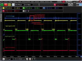

I have a typical H-bridge for a switching converter with two UCC27211A (one for leading/lagging leg) sharing the same Vdd. We are intentionally using the UVLO function to prevent switching by reducing the Vdd from 12V to 6V when the PCBA is in a reset state. I expect that when Vdd is 6V, there should be no output PWM from the gate driver since the output will become Hi-Z.
However, during my testing, when the Vdd is 6V and my DSP is driving the input PWM, I see that the gate driver output occasionally turn on. Please see the attached scope shots:

    I looked at some temp characterization data on this device and I see that at cold temperature the VDD turn off UVLO is lower, closer to 6.2V with a room temp of ~6.4V and hot of 6.5V. We will not be able to post detail test data on a public forum. I see some high frequency content (ripple) on VDD, and with being not too far away from the thresholds there may be a possibility of triggering UVLO  from noise. Is there any other possible means of disabling the driver? Stopping or interrupting the PWM inputs would be on method as well.

    For question #2, with the high frequency spike on VDD, how long does the gate driver stay on? The probe shows the spike is only for a ~2us and then the VDD returns to steady state of 6V. Do you have more details on the timing for setting/clearing UVLO? Is there any internal filtering for this?

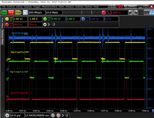

    Thank you for the most recent plot, it is interesting that the output seems to show every other pulse output response. You have a point in the 500mV hysteresis from the stop to the start point. The spec I noticed that would have me concerned is the 6.2V minimum rising threshold (start) when you pull VDD low to 6V.  This makes me think that worst case to guarantee a stop, worst case you need to get below 5.7V.
