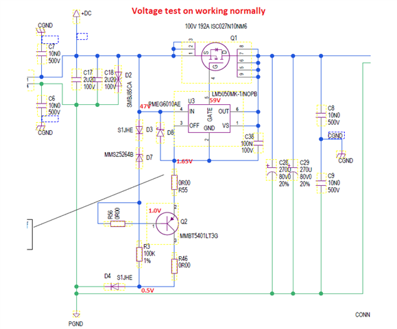

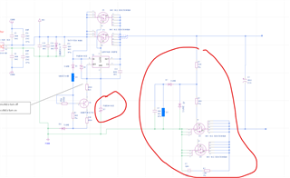

We are using LM5050-1 on our PSU's input reverse polarity protection and find some damage after surge test.
Their schematic is as below.
The surge voltage is negative, ~ 1000V from input side as below figure.
we found Q1's DS are short, D7/D8 are also damaged, which will make input (IN vs GND) are short and very big big dangerous current, could you please help to review if the schematic has some problem and give some advice to solve this surge test damage.
Thank you!
Bruce
  • Hi Bruce,
    Is D4 also damaged ?
    If yes, this means that D4 is not able to withstand the reverse voltage then subjecting LM5050-1 to negative voltage which it cannot withstand.

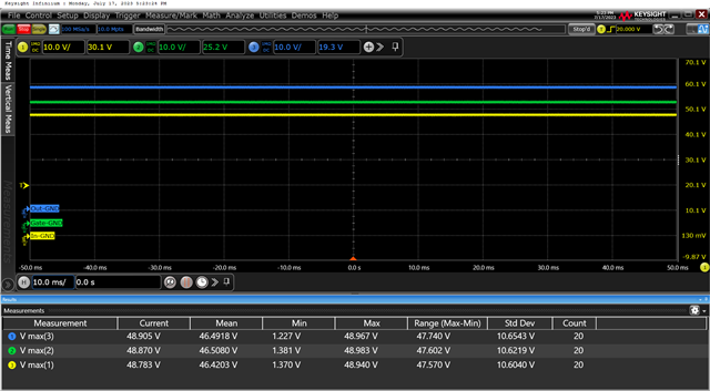

    Can you share waveform captures with IN-GND, OUT-GND, GATE to GND (all signals captured w.r.t IC GND)
  • Hi Praveen,
    I am sorry for delay reply, the attached is my test waveform for you checking:

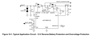

    For inrush current control, you will need a FET in load switch orientation. The FET in Ideal Diode orientation cannot block/ limit the forward current due to its body diode.
    For Input Reverse polarity Protection +  Reverse Current Blocking + Inrush Current control, you will need a device like LM7480-Q1 which can drive two back-to-back FETs as shown below.

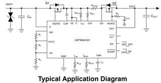

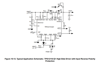

  • Hi Bruce,
    If reverse current blocking is not required and just Reverse polarity Protection + Inrush Current control are sufficient, then you can consider using TPS4811x-Q1family of devices in the below configuration.
  • Hi Praveen,
    our PSU will be used on telecom system, so reverse current blocking is not required, but we need reverse polarity protection and inrush current control;

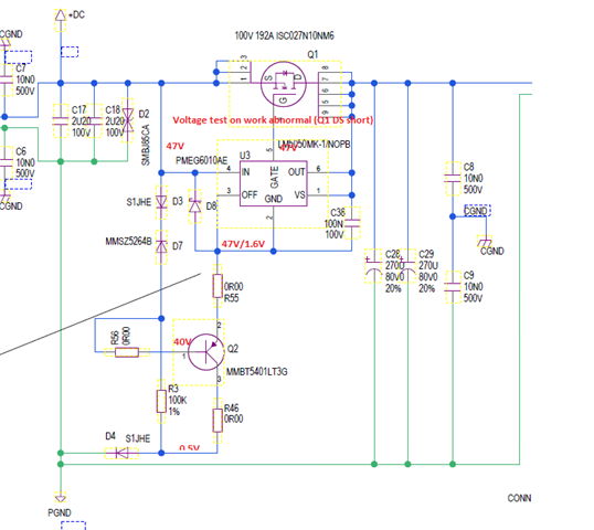

    for previous discussion for LM5050 design, I still want to have more better understanding to find root cause:
    below is some voltage value on normal and abnormal work condition:
    1. voltage test result on work normal condition (Q1 is ok);
    2. voltage test result on work abnormal condition (Q1 DS short)

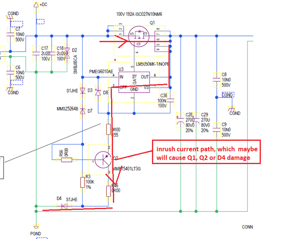

    3. why sometime Q1 DS is short, sometime Q2/D4 is damage, maybe there is some inrush current as below picture showing;
    4. base on above analysis, can we fix this issue if optimize my original design as below picture showing

  • Hi Bruce,
    The abnormal condition is a negative surge voltage of ~ 1000V from input side, right?
    you will have to capture waveform with IN-GND, OUT-GND, GATE to GND signals when the transient is applied and not during steady state condition.

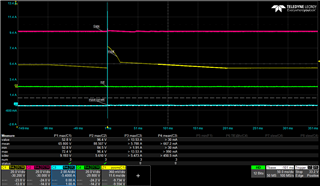

  • Hi Praveen
    I continue to do some testing today, now, I think this issue is sure caused by inrush current while hot insert DC cable,
    below is my detail test waveform, you can find thin input current is very big, which is more than 10x normal input current, unfortunately, my PSU are damage (U20 pin 3 and pin 5 are short) and I forgot save normal work waveform.

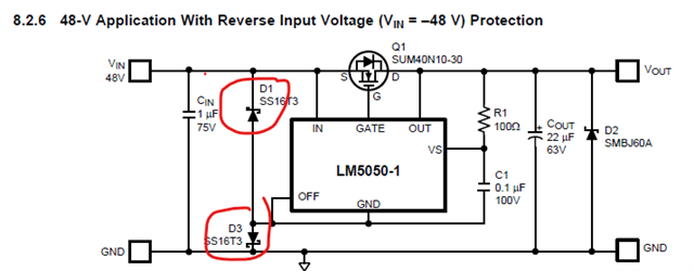

    Anymore, if I still want to use LM5050 for reverse input voltage protection, and add NMOS on negative line for inrush current protect, detail as below, do you thick below design is ok? my confuse point is the inrush circuit should be before reverse input voltage protection circuit or after it, which one is better?

  • Hi Bruce,
    The current spike in the waveform you shared is during input hotplug and this is because the current is drawn from input to charge the output capacitors of the board. As there is no load switch / Hotswap FET to limit the inrush current, the current peak will be there during hotplug.
    It is  better to have LM5050-1 (for reverse current Blocking + Input revrese polarity protection) first in the power path followed by a separate circuit for inrush current limiting.This will help protect the Input revrese polarity protection circuit from seeing input negative voltage during Input revrese polarity conditions.

  • Hi Bruce,
    Sorry for the confusion. It is  better to have LM5050-1 (for reverse current Blocking + Input revrese polarity protection) first in the power path followed by a separate circuit for inrush current limiting.

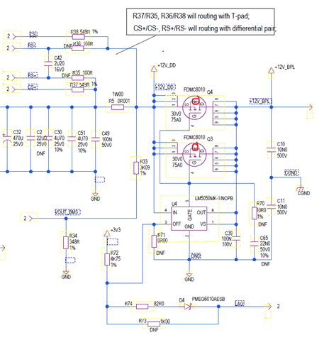

  • Hi Praveen,

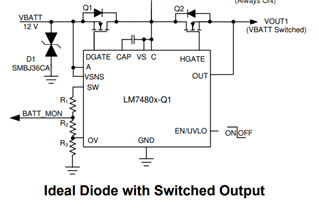

    one more question also need you help, on our PSU, we also use LM5050 for OR-ing and output hot swap control, detail as below picture showing.
    my confuse is the "LAG" will short to GND on backplane, if not insert PSU to backplane, which mean off pin will pull up to 3.3V, and then gate pin will output low voltage level to turn off Q3/Q4, however, there is some body diode for Q3/Q4, so there are still some current go to  the drain pins of mosfet, right? if yes, that's mean no hot-swap function anymore.
    do you have any good comment for this, thanks!
  • Hi Bruce,
    Yes, your understanding is correct. There is no control  on forward current when you are using just ORing/ Ideal diode FETs which have their source connected to input and drain connected to output.
    For inrush current control/ Hotswap control you will need a FET is reverse orientation that is its Drain connected to input and Source connected to output.
    So, over all you will need devices like LM7480-Q1 or LM74910-Q1 which can drive back-to-back FETs as shown below.
