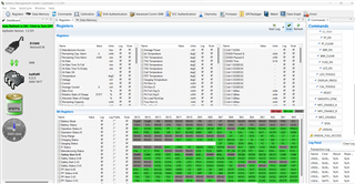

I have a battery cells measure problem and I can't access the cells even though I unsolved. I found a .srec file and updated firmware so these problems occurred. How can figure out this problem?

Hello Habibe,
It looks like you may be in ROM mode, please navigate to the Advanced Communication tab and send command 0x8 to send the device back to FW mode.
