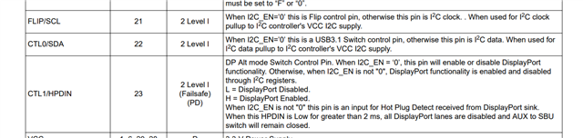

I´m use redriver mux TUSB546 and need to control with TPS25750, so, I would like to know how or with which pins I can control the mux redriver with Power Delivery?
So, if you have a any suggestion please share me.
