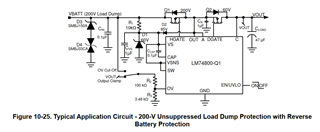

What is the typical and  maximum quiescent current in the following two scenarios:
1. VBATT = 12V, VA=0V, VOUT=0V, EN/UVLO=0V, VC =0V, VS=VSNS=VSW - fed from VBATT via10k
2. VBATT = 24V, VA=0V, VOUT=0V, EN/UVLO=0V, VC =0V, VS=VSNS=VSW - fed from VBATT via10k

    I do not see how that is possible, because in the common drain topology:
    A, VS, VSNS and C are effectively connected directly to VBATT, regardless of EN/UVLO state
    whereas, in the common Source topology:
    only VS and VSNS are connected to VBATT through a 10k Resistor and A and C are Open circuit
    To me this seems to be a significant difference which should result in a significantly lower quiescent current when it is NOT enabled - ie EN/UVLO=0

    The GND current measured when the device is disabled is called shutdown current.
    When enable is pulled low, there would be no current drawn into the A or C pins of the IC. So, The shutdown current will also remain same for both CD and CS configurations.
    Irrespective of CS or CD configuration, the voltage seen on the VS pin is the same. The 10k Resistor may limit the peak quiescent current (when EN = High) but the average quiescent current remains same with or without the 10k Resistor.
