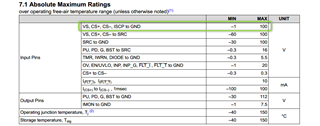

we have to withstand a reverse voltage down to -32V on the VS pin.
Is a diode sufficient to protect the inputs Vs, CS+, CS- and ISCP in reverse polarity condition?

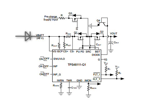

Hi Olrik,
Diode in the device ground path helps to provide input reverse polarity protection. Please refer Figure 2-2 in application note https://www.ti.com/lit/an/sluaan7/sluaan7.pdf
