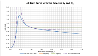

    3.What does fN(Mg_max) and fN(Mg_min) mean at calculator tool line 103 and 104? how can I get both value on this diagram?
    You will have to hover on the gain curve as suggested in the following screenshot.
    For more details on the design calculator, please see the design example of the app note in page number 21: Designing an LLC Resonant Half-Bridge Power Converter Article
