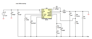

I'm trying to design an inverting buck-boost using the TPS54620 for an aerospace application.
1. Imported the unencrypted SPICE model into LTSpice (only available SPICE software at my current job). Simulation seems to work fine when configured as a synchronous buck converter, but I get a SPICE error message whenever the simulation finishes.
2. Cannot get the simulation to work at all when configured as an inverting buck-boost. Simulation hiccups at around 500us. Any advice?

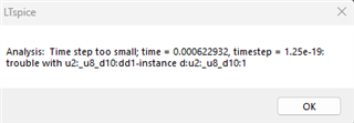

Repeated SPICE error message:
Questionable use of curly braces in "b§e_u12_abm157 u12_n16721150 0 v={if(v(u12_n16721160)>0.5,v(oclow),0)} "
Error: undefined symbol in: "if([v](u12_n16721160)>0.5,v(oclow),0)"

WARNING: Less than two connections to node u2:set0. This node is used by v:u2:_v47.
d_d: Emission coefficient, N=0.01, too small, limited to 0.1
Direct Newton iteration for .op point succeeded.
Ignoring empty pin current: Ix(u2:pvin)
Ignoring empty pin current: Ix(u2:vsense)
Changing Tseed to 1e-08
Heightened Def Con from 3.94984e-05 to 3.94988e-05
Heightened Def Con from 0.00224018 to 0.00224018
Heightened Def Con from 0.00790351 to 0.00790351
Date: Mon Jul 17 19:08:39 2023
Total elapsed time: 99.052 seconds.

Demo garbage circuit just to get the simulation working:
