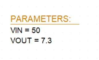

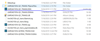

    Try simulating for a shorter amount of time. You should get the idea of how the device performs over a couple ms. It also helps to start with the files provided on the device page and modify them.
    All I need to do to match get your design specs is to change the VIN and VOUT parameters.
    Let me know if this works.
