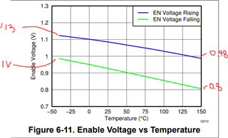

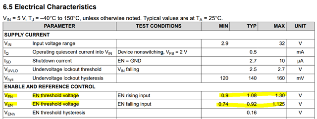

We are planning to put voltage divider before Enable pin of TPS55340.
We are confused about that 6.5 Electrical characteristics Ven is quite different with the Graph Figure 6-11.
Please let us know which one is right. Thanks
