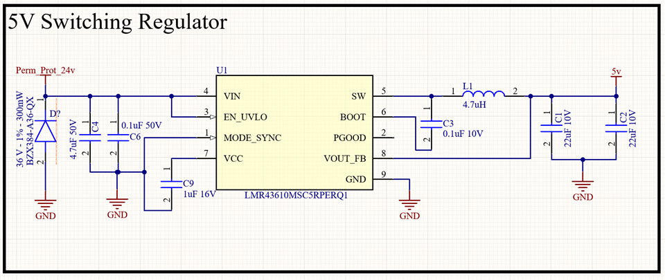

LMR43610-Q1: ESD and transient requirements for this device
Part Number: LMR43610-Q1
Hi, I saw on the datasheet that the absolute maximum rating is 42V, however there is a larger ESD value. I am thinking of having this supply voltage from a 23-32V DC PSU to my PCB, will these values of suppression and circuitry satisfy the regulator circuit I have? Do I need to add any other protection to support this device?
I appreciate the help, thank you!
