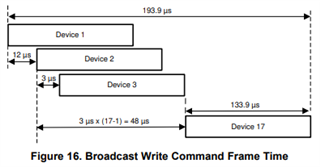

We are considering compensating the propagation delay of ADC_GO command transferred from the bridge IC to the pack and cell monitors.
  • How to calculate byte-to-byte delay? In "BQ79606A-Q1 Daisy Chain Communication Timing", it says that byte-to-byte delay is fixed by UART baud rate and the estimated delay for 1 Mbps is around 1.925us. Could you show me the formula? In addition, I notice in the datasheet of BQ79718 the byte-to-byte delay becomes 2.5us for 1Mbps. Could you please tell me why?
  • Is the re-clock time between cell monitors 4us? What about the re-clock time for the bridge IC and the base device?
I'd appreciate it if you could share me a picture of ADC start command frame like the picture below:
Thanks for support and best regards,
Jiahao

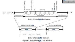

    Please see below for question one for BQ79718. There is no formula, it is the nature of the daisy chain protocol. Here is why there is a 2.5us gap between byte's
    For question 2 the re-clock time is 4us between 718s and between 600 and 718.
    Chase
