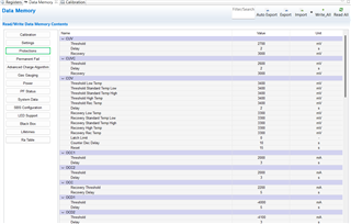

Hi everyone,
I try to testing protection functions of bq40z80. However q studio bq40z80 when start cov protection doesnt stop the charging. Still continue charging when voltage above the threshold voltage(cov). What can I do?
  • Hello Habibe.
    From the snippet you show the gauge is showing SafetyAlert() which will not disable the FETs until the voltage is above the COV threshold for the COV delay time.
    Sincerely,
    Wyatt Keller
  • Hello Wyatt,
    Yes I know that but fets are enable again after delay time and charging continue.
  • Hello Habibe,
    Please share a BQStudio log of the test and the .gg file with your configuration. If your cell voltage is above 3400mV for 2 seconds you should see the charge disabled as long as the COV protection is enabled in your settings. It is also possible you could be tripping the protection then recovering again since recovery threshold is at 3300mV. We would need the log to confirm.

  • Hello Habibe,
    The shared log does not represent the test you explained previously, in the log all the cell voltages except cell 1 go to 0V which will trigger CUV and stop any discharge. Please explain your SOP (standard operating procedure) for the tests you are performing.
