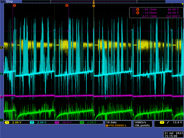

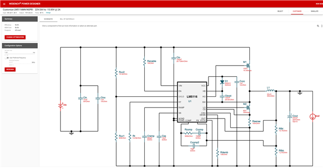

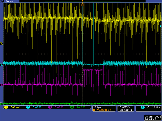

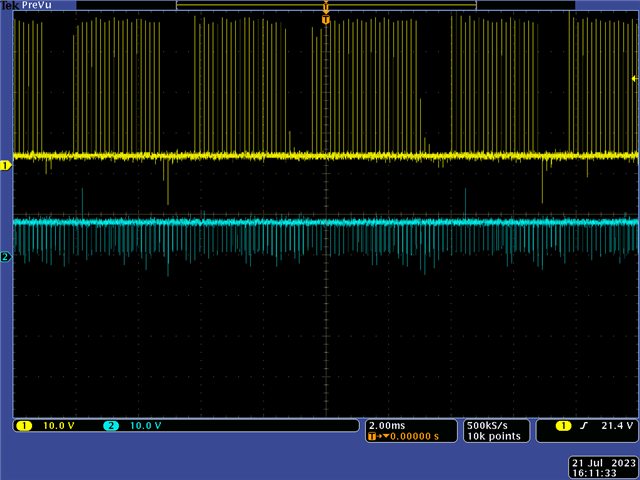

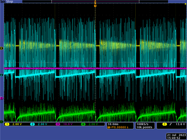

I am using a Webench Power Design.  All I can get out of the design is -0.5V.
Some component values that have changed.
C17 (Cboot) 0.1uf
C20 (Css) 15nf
R13 (Rdemb) 12.4k

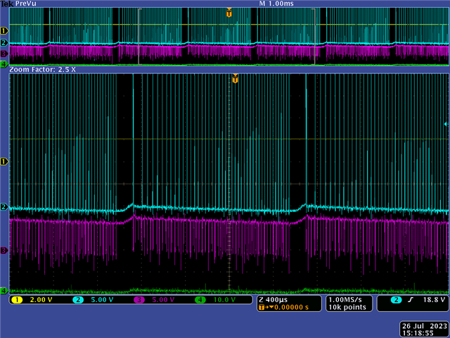

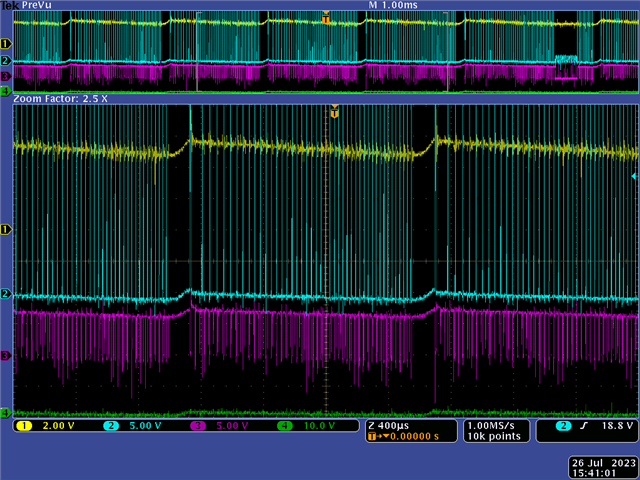

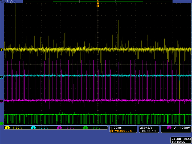

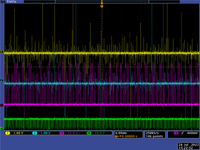

After power up (24V) the output is -0.210V.  Then touch a voltmeter probe to R13 and the voltage goes to -0.455V.  The only load is D6 and R15.
Any help would be appreciated!
