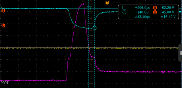

Hi Team,
We want to know how to select BOOT capacitor value. If we calculate the value based on the formula C=Qgtotal/ΔV, ΔV=VDD-UVLO, then we choose 10 times to the calculated value. This boot capacitor can not drives normally. The waveform as follow: red line is Vgs, blue line is Vboot.
If we set the boot capacitor to be particularly large, what influence will it happen? BTW, can you confirm whether we can combine two BQ76200 DSG or CHG to Improve driving ability?
