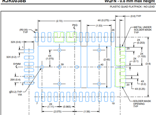

Hi Expert,
How many thermal vias do TPS25750 need?

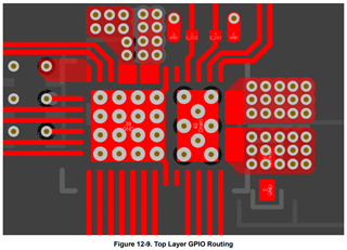

Hi Far,
Please see example layout below:
I recommend having as much thermal vias as possible to dissipate as much heat as possible to the GND plane.
