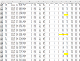

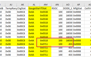

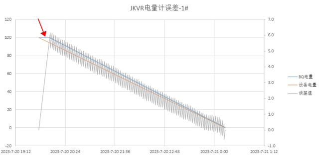

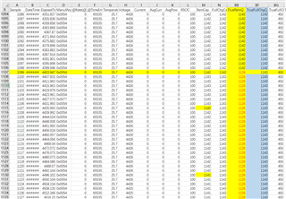

Battery Charge Term Taper Current/300mA is not set to 100% RSOC, but is advanced to 707mA, resulting in 100% RSOC duration at discharge is too long, causing the overall accuracy to decline, this battery has done a lot of cycles and learning, has not been getting better, excuse me TI engineers this situation need to improve?
