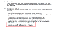

BQ4050: BQ4050 CEDV
Part Number: BQ4050
How to define these parameters?
    I'm not sure if you attached multiple pictures, but only one came through.
    The FltMinSOC and FltMaxSOC is the range used by the tool to calculate the coefficients, essentially the slope of the compensation at EDV. The LearnSOC is the EDV2 point.
