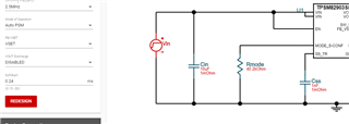

Dear TI Community,
it seems that the WEBENCH Designer does not consider the VREF/0.75 factor.
Vref= 0.6/0.75=0.8V
Css=Tss*Iss/Vref
Css=0.24*2.5e-6/0.8=750pF.
WEBENCH calculates 0.24ms with 1nF
Wolfgang

thanks for feedback, please calculate with 0.75V factor firstly, we need some time to check with model team.
Yuchang
The model should not cover 0.75V factor, but some time needed if update the model, you can calculate based on datasheet firstly
BTW, what's soft-start time do you need?
